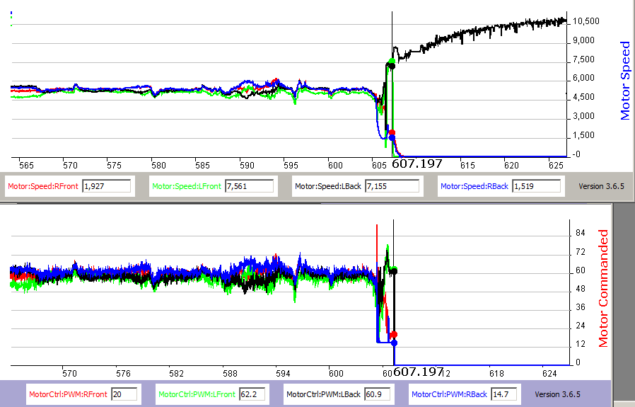

Well, that’s kinda strange. The .DAT shows what you described - that the leftBack motor continued to run although all the motors were being commanded to stop.
But, the ESC temp starts to rise.
So I’m gonna guess that the ESC failed in an “on” state.

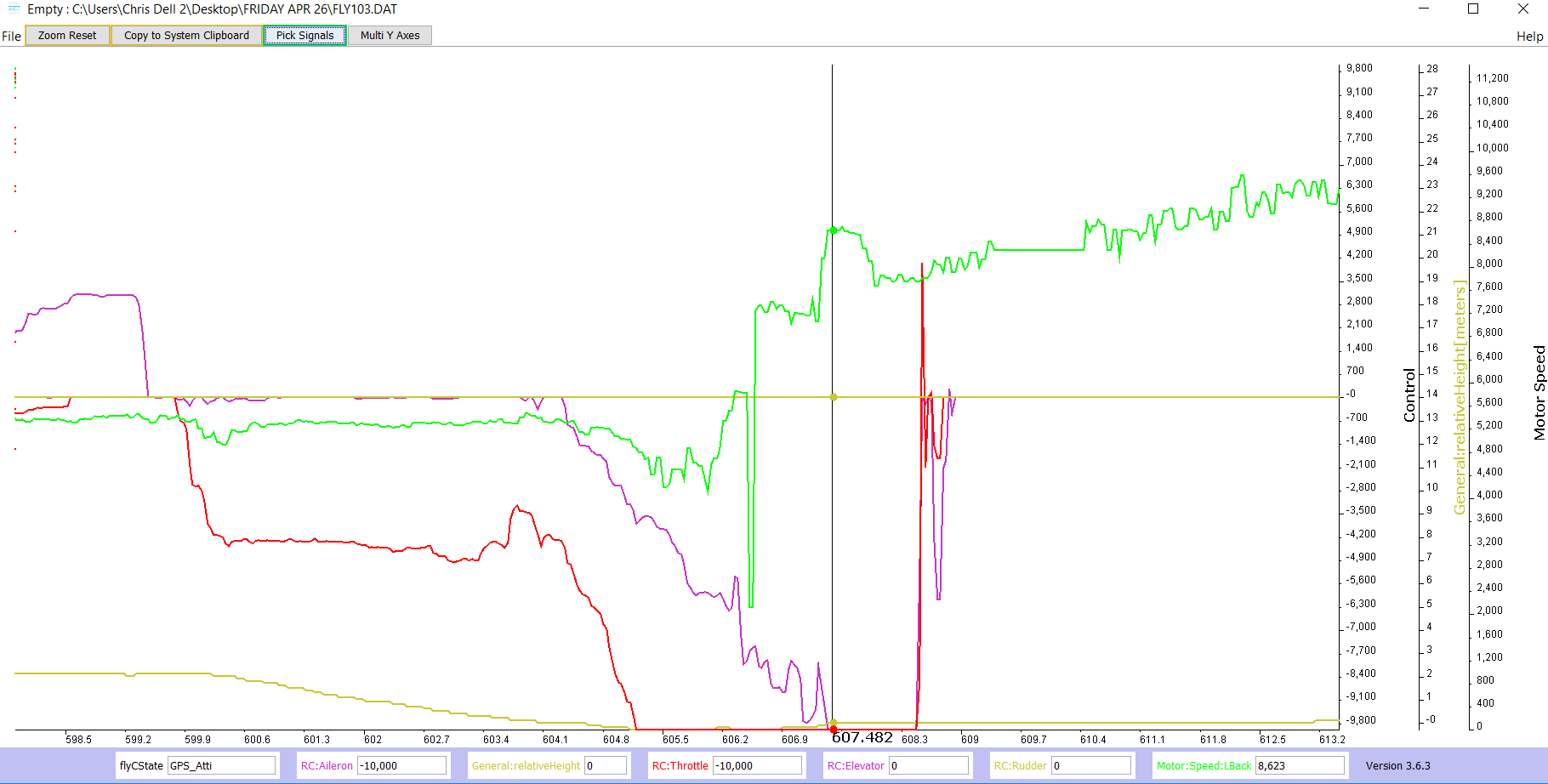

This may have no bearing on the apparent ESC issue, but did you use a CSC to shut down the motors? This can cause a motor to keep running and flip the aircraft, but granted normally for not long. That’s what it looks like and just wanted to point that out.
Is this a CSC? The rudder and elevator input is neutral.
I did see that, but why else would the aileron be at max along with the throttle? That is the first thing that came to mind. Mainly was just curios as to the reason for it, if there was one.
I’m not sure I understand the question. But, it wasn’t a CSC.
The question being, why the aileron inputs while shutting off the motors. Iv’e never seen anyone do this unless it was in the process of a CSC. The full down throttle is normal. The aileron is not. That was the question.

My point was when you took the throttle down to turn off the motors, you also gave full aileron at the same time, which is odd if you are using the standard throttle down only for 2-3 seconds. CSC is how you start the motors on a P3…not stop them, although that will work, it usually results in a flip over.
Just to be clear. CSC is both sticks down and in. Rudder full positive and aileron, throttle, elevator full negative. CSC was not performed here.
Agreed. Maybe I wasn’t clear enough in what I was attempting to say. What I am suggesting, and this may or may not be related whatsoever, is the fact that I have not seen ( Not to say it hasn’t occurred before ) anyone give unnecessary inputs to stop the motors. Either a CSC or a full throttle down ONLY will stop them. Just as a speculation, the timing of the throttle down and aileron inputs in this particular case “might” cause an issue. Unsure of that but the possibility is there. Full throttle down occurred at 605.1 seconds. At the same time the aileron was being moved. Full aileron occurred at 607.4 seconds. Motor shutdown ( Except for the Left Rear ) occurred at 608.3 seconds. Just my thought, but the aileron input during the shutdown process “may” have flipped the aircraft, which in turn “may” have resulted in the OP’s description of the event and the subsequent ESC failure, presumably. Like I said, it is just a thought. I hope that explained better what I was thinking.
Look at the Roll value at the spike in the motor speed. It looks like the aircraft was rolling over from the aileron input.
Zooming in a bit it looks like the roll close to the ground may have caused the left props to strike the ground at 606.525. There was an abrupt decrease in speed but then it recovered.
I suppose it’s possible that a prop strike may have caused the ESC to fail.
Looking at this incident some more I don’t see any evidence that the P3AP actually “flipped”. Did it really flip @Rod ? The data shows it rolled to -58° for about 3 secs then righted itself.
That is what I was attempting to explain. The RC aileron input during motor shutdown appears to have caused the hard roll, just as a CSC might do while stopping the motors in that manner. I didn’t see any actual “flip” either. I was using that term generically. I didn’t mean there was an actual CSC, but the results are similar.
No it didn’t flip over.
