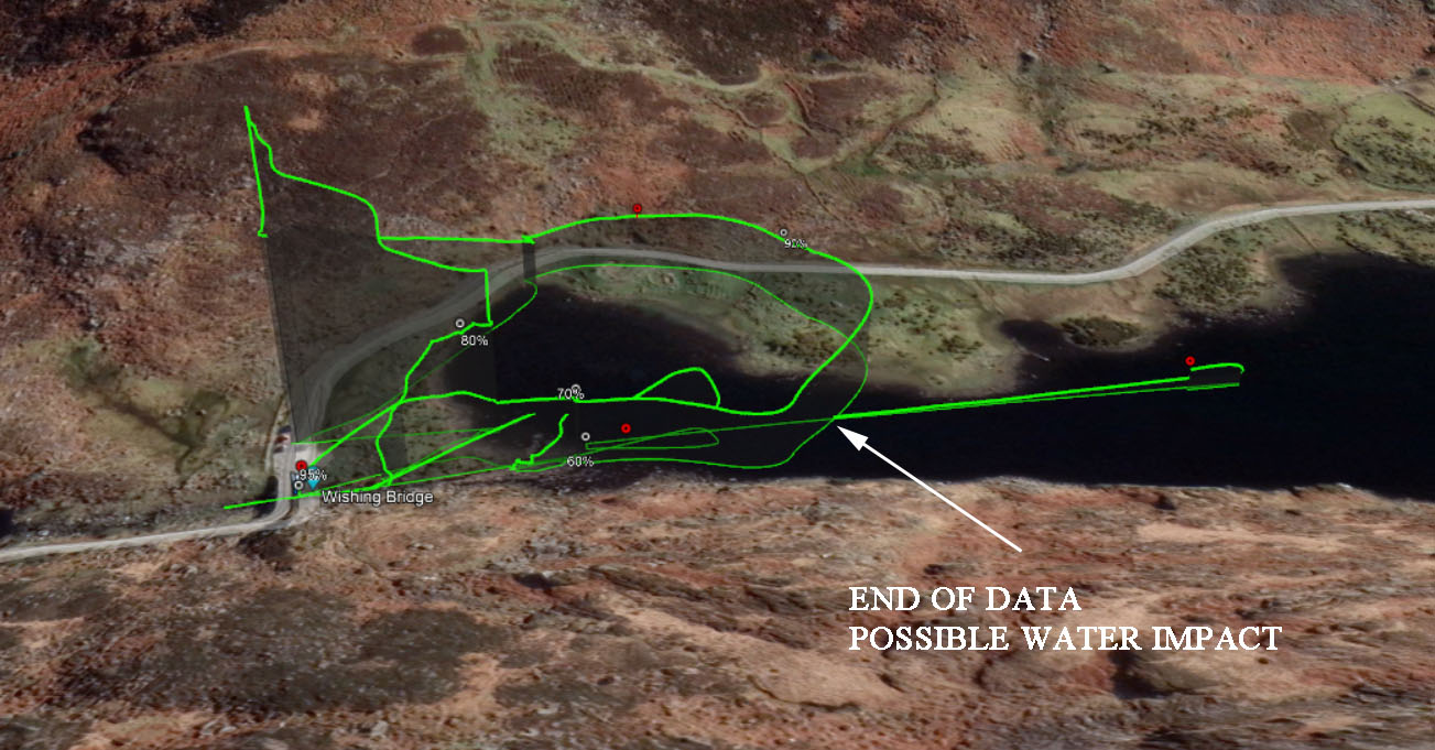

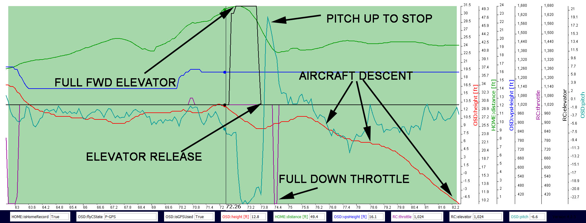

First, it appears that you were flying in reverse stick mode. This is very rare to see and is sometimes difficult to correlate. Normally, 99% of the time, the Right Stick is Elevator and Aileron, with the Left stick being Throttle and Rudder. Yours are completely reversed, but that is an option so no fault of yours for that. Secondly, You were extremely close to the water. Too close for comfort in my opinion. You were traveling at a very high rate of speed at close proximity to the water, when you released elevator and the aircraft performed a very hard brake, pitching up then recovering for a brief few seconds. At the very last data point the aircraft was loosing altitude at which point the data ends. I have seen at least 2 Mini’s loose data transmission after such hard braking. Not saying that is the cause but it is possible. According to the GE profile it looks as though you did hit the water, but I will say the data does not exactly show that. But IMO, that looks to be what happened in this instance.
See Profile and Data below. Again, not confirmed, but probable.

Kind of hard to keep a visual at 175 meters at basically water level with the terrain and water levels differing. At least from the GE standpoint. Especially with a Mini. That aside, Hard braking is never good for the aircraft. That can be adjusted in the app I would assume. At least that has been the case for most of the other aircraft. As I said, no fault of yours for the control reversal, that is the pilots option. But that is seen so rarely that most analysis software doesn’t account for that. Just for reference, braking that hard from a high rate of speed can damage a prop or most anything. Yes, It is designed to handle that, but only a few times and something will break most assuredly. You went from 56KMH to 0 in approximately 2 seconds…

Not confusing really. Once you loose transmission signal, you also loose data transmission back to the remote, so the data ends at that point. The aircraft could still be airborne, but with no transmission or reception, no additional data. Additionally, it looks like you were recording video for the final 2 seconds of data. Did you happen to look at that? It will only be a few seconds long it appears.
Also my appologies for the image posted previously showing the flight profile. Where I show the flight ends is incorrect. It actually ends at the RED DOT farthest from your home point where you lost signal.
The profile was so low I couldn’t tell the elevation.

An Error in the VPS is quite possible, especially over water. It doesn’t respond well over water. I personally don’t think that is the “root” cause. The data really doesn’t reflect that. Here is your VPS vs Barometric Altitude. Bear in mind there are errors over water, but not with the barometric altitude.

That said, the second chart shows a similar event. An abrupt stop, however you were traveling no where near the forward speed of the previous incident. You did however issue full down throttle while the aircraft was braking. Following that, it appeared to rocking all over the place until the end of data ~8 seconds later. Inconclusive at best.
