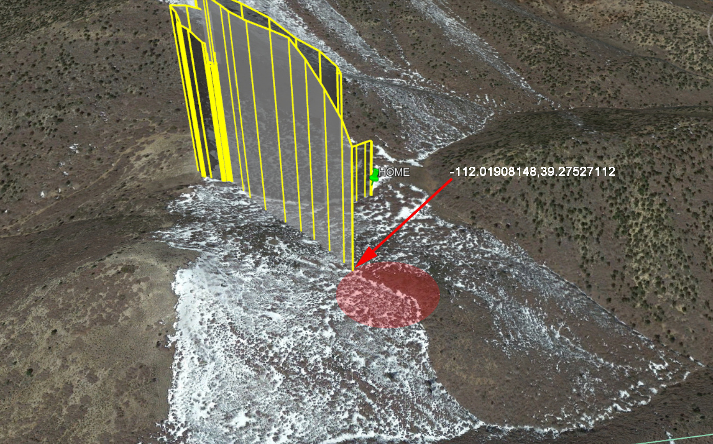

Are the GPS coordinates in there, or will they be the same as the ones when I use find my drone from the app?
They should be the same. Both should have the location prior to disconnect. Will do some calculating and locate a better spot for you if possible…
Wow, thanks for all the info. I really appreciate it. Any help would save me walking hours and hours through the densest oak brush
Your last logged location is shown in the image below. The aircraft was already auto landing from 150ft and should be within the red circle.
Ok thanks. One last thing. Why is the last last logged location at the edge of the red circle and not in the middle? Do you think it would have drifted more in the direction it was traveling?
The circle is extended due to the aircraft’s altitude at autoland. The edge is the last reported co-ordinance. Without wind data it is the best guess I can give you. The aircraft did not appear to be increasing in distance at signal loss, so the remaining 150ft descent should be accurate well within that area.
Ok thanks again. At that point the drone was in on last contact, would it look for a safe place to land or just go straight down and land in trees or whatever. Seriously, thanks again.
Autoland is straight down, unless there are “intermittant” RC inputs, excluding the throttle as I mentioned. Or if the winds are too strong to maintain positioning. Which even at that should be within the circle, I would think.

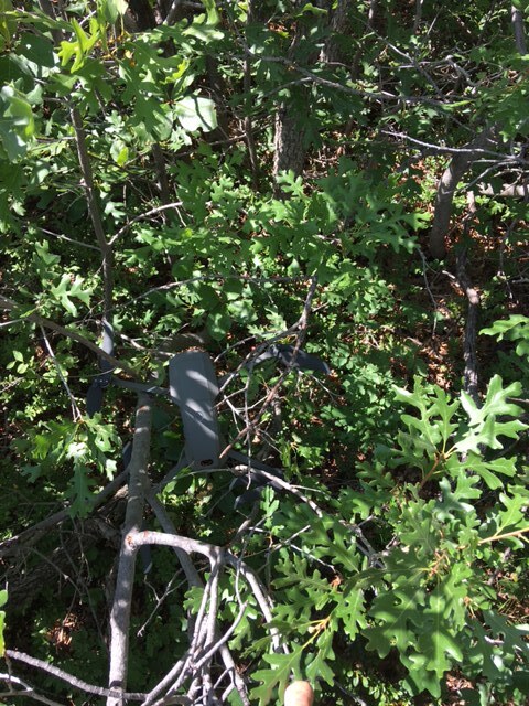

Excellent! Glad you found it.
Glad you found it. I lost one in heavy brush once. Luckily I had another drone and was able to find it with the spare,
I have another drone too and took it with me the day I found it. I was going to use it as a last resort after I searched the ground. But honestly, I don’t think I would have found it with the other drone. It had flown into a dense gamble oak patch and was pretty deep and hard to see from above.
