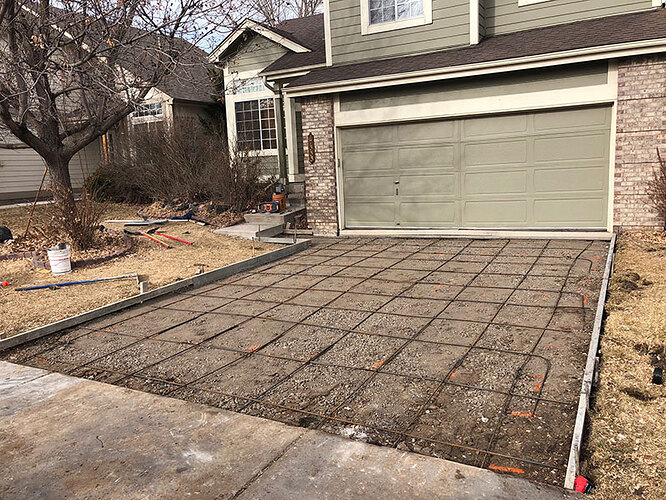

In your first log, it looks like you took off from a concrete driveway. Many concrete structures contain rebar.
Hi msinger,
Yes i took off from the car park at work.
That was likely the issue then. In order to prevent a situation like this, make sure you’re doing these checks before taking off:
