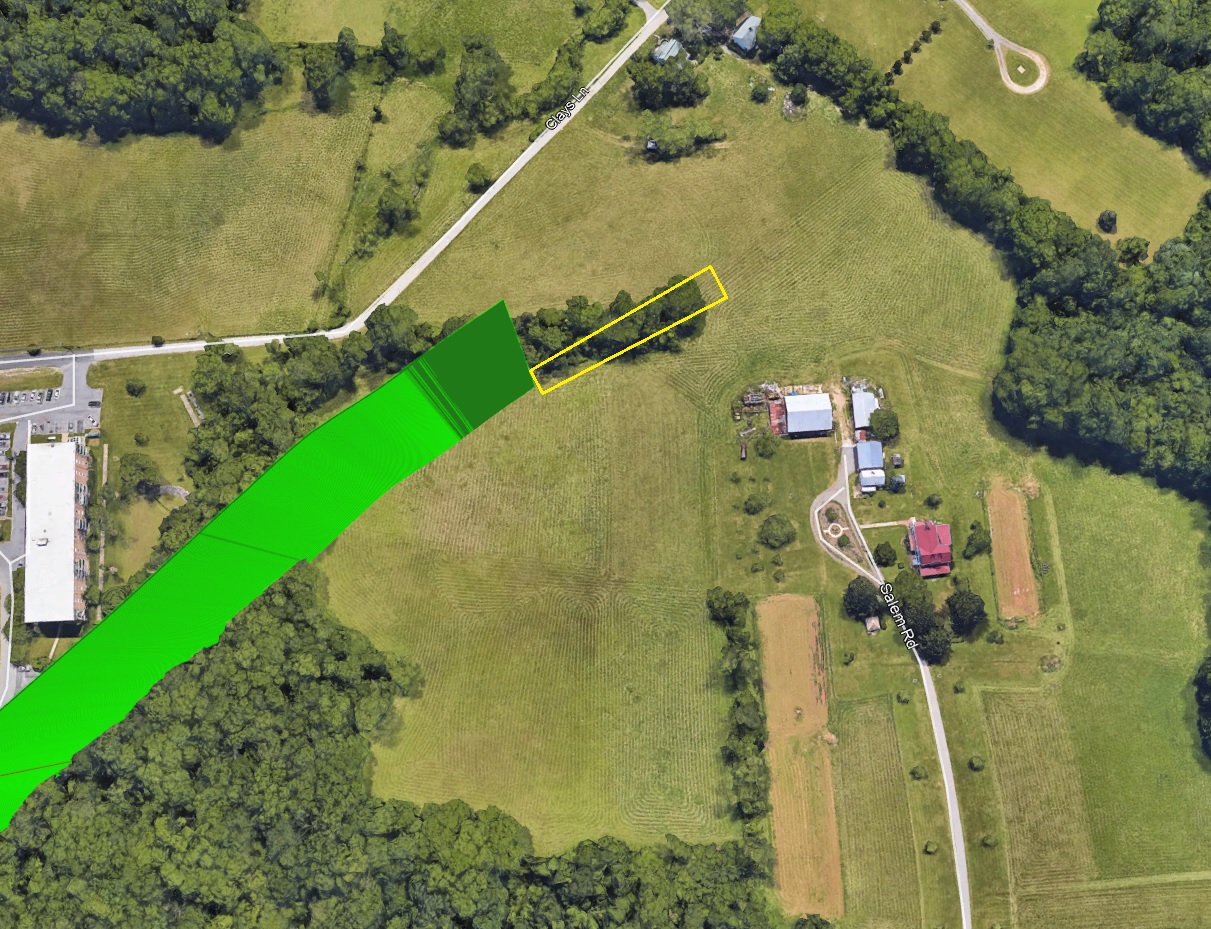

The flight log shows the last location at 39.33631956 ,-76.76708413. Since your flight log shows no signs of strong wind, your Spark should have definitely been able to make it back to the home point if it tried to return home. Since that did not happen, I’m thinking the battery might have disconnected mid-flight or a hardware failure caused it to crash.
If it crashed at that location, you’ll likely find it somewhere within this yellow box:
Ok. I’m on location now. I’ll walk over and look around. Do you think it would’ve descended gradually or crashed rapidly?
If the battery disconnected mid-flight, it would have dropped like a rock.

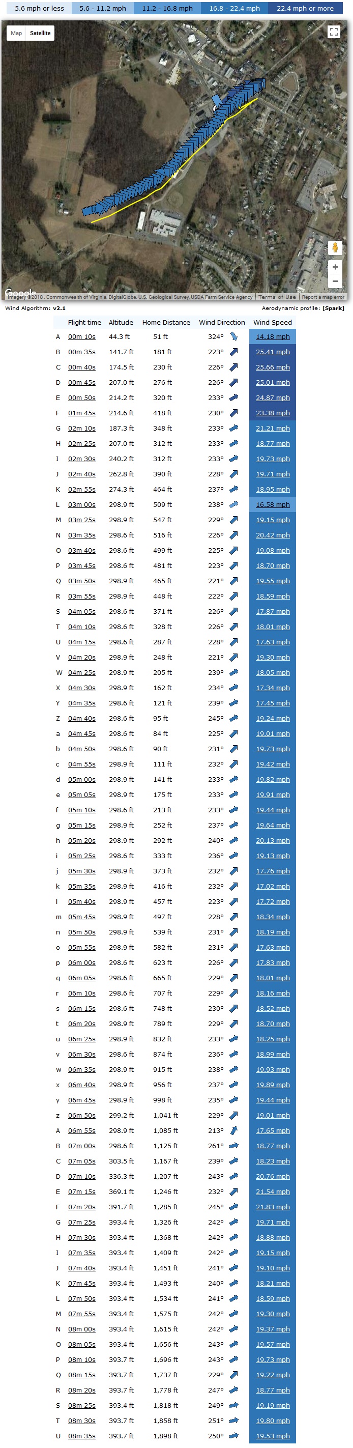

According to Airdata, the inflight wind speed was stronger than I thought. Here’s an overview of the wind data for the entire flight:
Wind2
Here are the wind calculations for the entire flight (click the image to see the table on the bottom):
At the points in your log where the Spark was hovering in place, you can tell the wind was blowing since the pitch and roll were not close to 0. However, the wind was not strong enough to prevent the Spark from holding its position.
The wind was blowing toward the direction of the home point after you flew over top of the school. So, that should have helped the Spark fly back to the home point had it attempted to return home.
