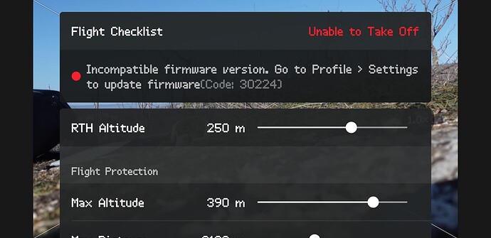

Hello again, yestedray this occured to me:
I updated my FlySafe database and took off - only to realise only after a few minutes in the air that I cannot ascent the drine anymore. It did not ascent when I triggered RTH and it did not ascent even when I put my hand below it while it was landing.
Then it said “Firmware incompatible” and it does not wanted to start the propellers…
Restarted the drone and everythig was fine.
My question overall is will this happen again in the middle of a flight ?

There have been various fixes for this issue that have worked successfully for many years. Here’s a lengthy thread on the DJI forum where users have shared their solutions:
If you weren't using a new battery for the first time, then I think the most likely culprit is the DJI Fly app caching bad data locally. Since the exact cause is unknown, it's hard to say whether it will happen again.
As for using Flight Reader, it’s likely not going to be helpful for this specific issue since it falls outside of data that’s recorded in the TXT flight log. However, it would be useful for reviewing flight telemetry data.

However, both the altitudes shown in the image you provided are illegal in the U.S. Max altitude is 400 feet, not 400 METERS. My old Phantom-3 is set to 30 meters maximum altitude.
The altitude you show of 390 meters converts to 1,280 feet, far higher than altitudes we use in police helicopters for normal patrol, and also medical transport helicopters travelling between hospitals.

I removed my SD card before powering in the drone and it came on just fine. Just insert the SD card back in after the drone comes back on.
