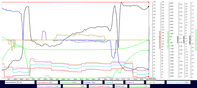

Is this common,? It just fell out of the sky. this is the flight record. https://www.phantomhelp.com/LogViewer/QJ7ENCFZLV13L2ZQ7ROI
Thanks in advance.

This appears to be a battery dislodge. Unfortunately, P4’s have this issue with the battery latch seemingly. There have been numerous reports of this occurring. The last manuever in the log indicated a pitch up of ~25 degrees in response from the reverse elevator. I suspect that is what caused the disconnect.
I think so. Thanks for taking the time to reply.
