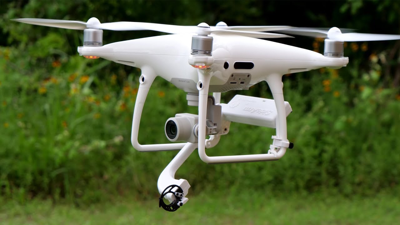

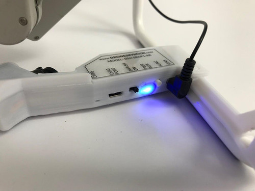

Also more of a bolt-on external package but does allow it to be wired in to the front light and be controlled by C1/C2 on the remote:
Other info for similar devices (dated):
There are many more like these. I am not endorsing nor advocating the use of any of these products or a DIY solution created by the OP. I have no experience with any of them. Simply providing information.
In any event, the idea of wiring from the P4’s lights & controlling the release via assigning “front LED” to C1 or C2 on the remote may be quite helpful to the OP for designing his own solution… Providing power to an external device is not as simple but also possible.

The Sky-Hook works the same way: clip-on light sensor on the front arm LED, which actuates the release when you flash the light using the RC C1 or C2 button. No actual wiring connections to be made (I realized I said “wired in” in my previous post which was an unfortunate an inaccurate way to word it).
The SAR box is indeed a very old product and may be hard to find (the Sky-Hook is old too but seems to still be available).
