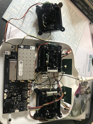

+++++SOLVED - Controller repairable +++++

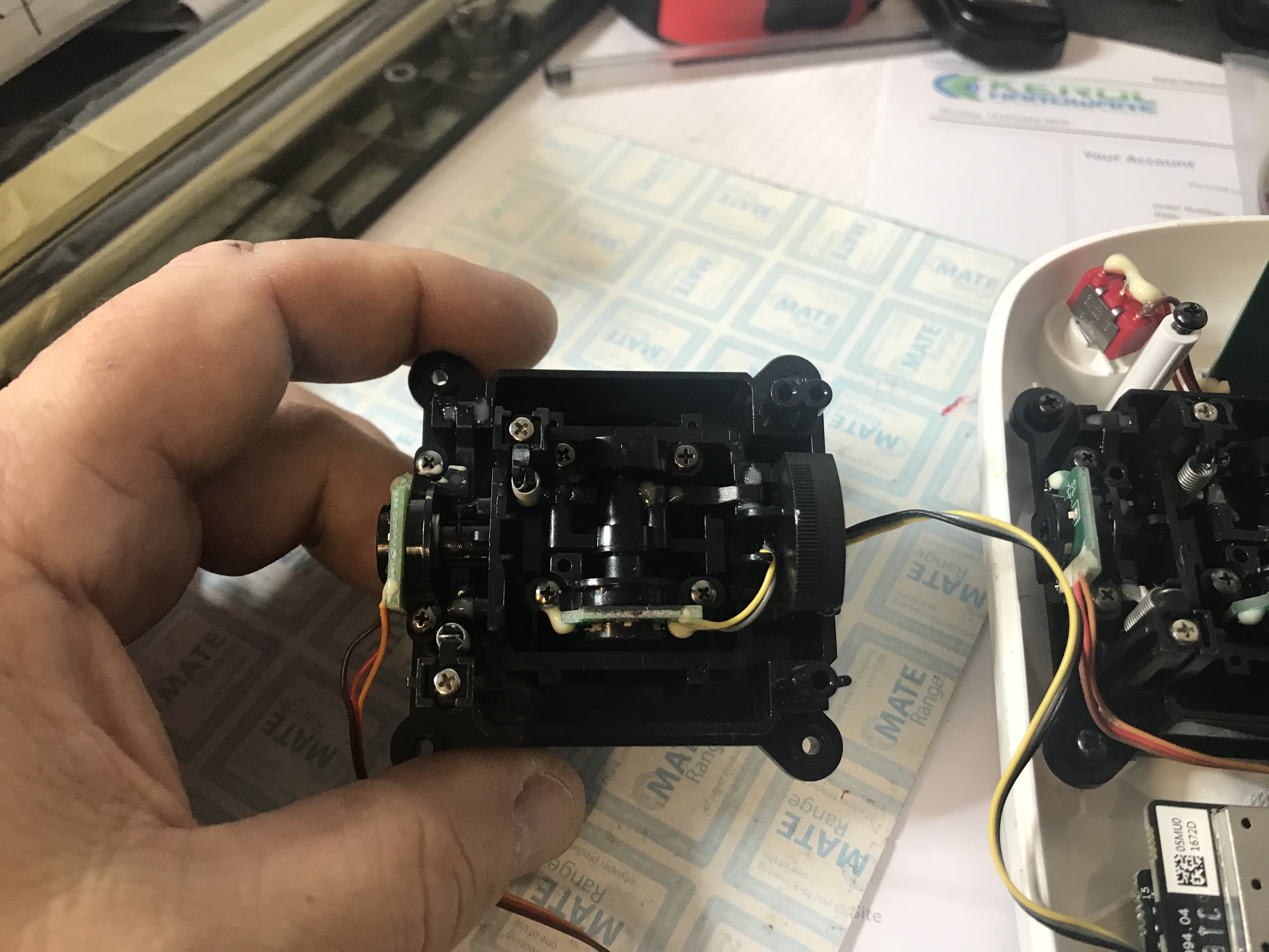

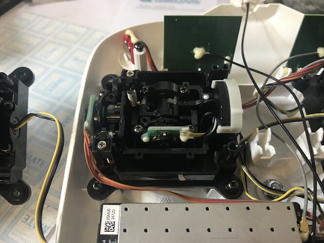

So after realising that there was an issue with the right controller joystick, I took it all apart. I removed the right stick mechanism in its entirety and went on the hunt for either a new one or secondhand one. Little did I realise how rare they are. There were many Phantom 3 Adv / Pro controllers for sale for a lot of money but I stumbled across a Company in Surrey called TFix. They were advertising parts for a broken up Phantom 3 Adv / Pro controller. On closer inspection of the pictures, to my mind, the joysticks looked exactly the same as the standard controller. For the sum of £13 with free delivery to me here in Northern Ireland I purchased the item.
This morning (a day earlier than stated) the part arrived. I have just fitted it to my controller, re-calibrated the joysticks through the DJO Go app and ‘hey presto’ … 1 x fully functioning controller. I have just taken the P3S out for a check flight using the repaired controller and all is well.
I will now dissect the broken joystick to see if the issue with it is terminal or otherwise.
