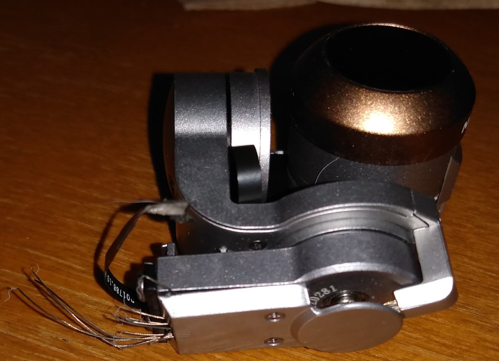

Well, I found it!!! It’s wet from rain,the camera mount is broken, but I found the camera itself. It seems ok. Now I’ll have to figure out if I can buy a new mount, and see if the wiring which was ripped out is replacable…
