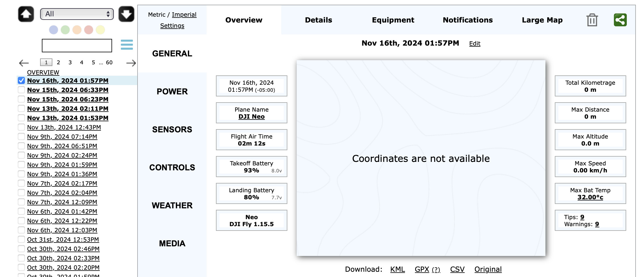

I flew my NEO inside my house and for most of the flight there was no GPS. The drone was flown with the RC-N3 controller. The log in DJIs Flight Data Centre indicates the duration of the flight was 12 min, but the log in Flight Reader shows a flight of 2 min 11s. Also the landing battery entry is not correct as well. Is this because the drone only had GPS for a short time (2min 11s ??)? I don’t normally fly my drones in my house so have never encountered this problem.
FWIW, AirData also indicates a flight of 2min 11s and the same landing battery, so it is obviously not just Flight Reader.
I’m just trying to understand why this is so. I didn’t expect there to be any map because of no GPS coordinates but did not expect flight time and battery data to be off.

Here’s what I see in Flight Reader 1.6.22:
Airdata also shows the flight time is 11m 54s.
I am not sure what is going on. I was running 1.6.21 but updated to 1.6.22 and reprocessed the log to see if that fixed the issue but it’s still the same. I did not import the log manually from the file I sent you. In both Flight Reader and AirData the log was automatically uploaded.
Here’s my screenshot after updating and re-processing.
Here’s the AirData log screenshot.

I have uploaded the flight log that I sent you (the one copied from my iPhone) to Flight Reader and now the log file is correct.
I did the same for AirData and it is also correct. I have the two logs: the auto upload one which is not correct and the manually uploaded one which is correct.
So, it seems like there was some sort of error in the auto-uploaded log because the one copied directly from my iPhone is correct.
Here’s the screenshot of my Flight Data Centre:
