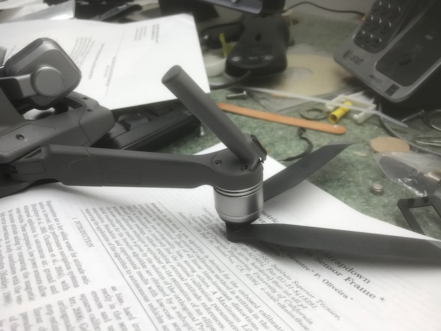

Yesterday I had an incident that must have been a bird strike. The left front landing leg was folded back
and the underside of the right front prop had some streak marks that look kinda greasy.

Have any luck tracking down that replacement part? If not, maybe you could weld it with something like this until a replacement part is available:
Wow, how unfortunate. I had my Spark in the Air the other day and a Hawk was circling it. I brought it towards home, within my range. My Mavic 2 Pro hasn’t had any such encounters yet. Those birds of prey will attack drones for sure, based on size. Good luck with your repairs. Safe flying!
@BudWalker, is the Mavic all patched up again? I’m interested to hear how your repair went.
Not yet. It’s flyable as it is and I haven’t had a lot of time lately.
