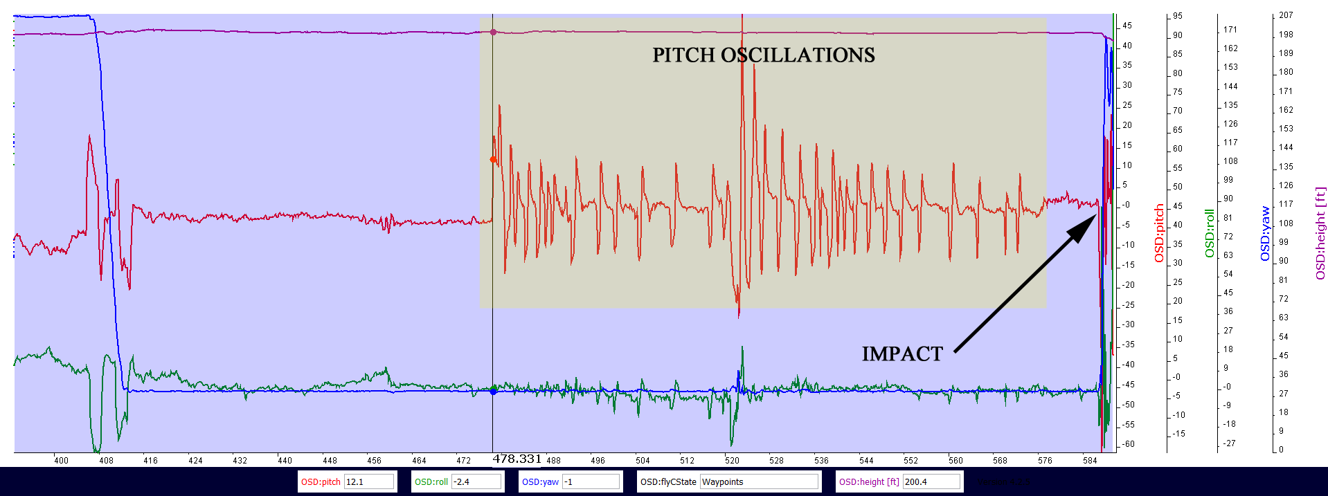

My MP2 crashed into a tree during a DD mission. I was able to extract the log from DD and use Airdata to locate its last position. I found the drone in some soft ferns and it seems to be fine. I’m trying to understand what happened, specifically how obstacle avoidance behaved. The flight altitude was set to 200ft but I thought I changed it to 320 because I knew there were some big trees on the outskirts of our property. Obviously I didn’t change it. From the logs, it looks like the drone slowed down at around 7m 59s. and probably dodged around a tree but someone on another forum thought it might have been struck and then taken down by a bird. There are eagles and hawks in the area. I haven’t measured the height of the trees in the area but they are huge. I’m wondering if anyone out there can extract more info from the log. The Flight Reader map sure looks like obstacle avoidance kicked in but the spreadsheets dont seem to show that they ever kicked in. Here is the link:
