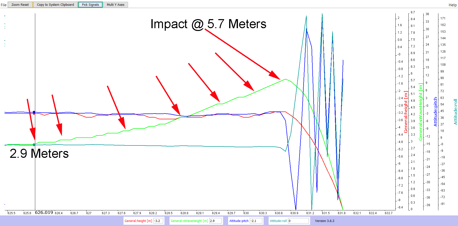

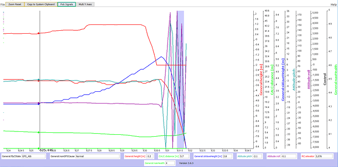

At ~625 seconds, the VPS indicated you were close to the ground. The aircraft very slowly began to climb. ~5 seconds later you hit the underside of the bridge.
According to the DJI GO 4 program, it was 2.7 meters VPS

The VPS was commanding the aircraft to climb. It slowly climbed for ~5 seconds before hitting the bridge.
You were also giving forward throttle at the time of impact so your statement is incorrect reguarding the sticks.

That is correct. I just explained why you slowly gained altitude. VPS over water is a tricky adventure. Depending on the circumstances.
I have to look how to understand the graphics that you have sent me. Thank you.
