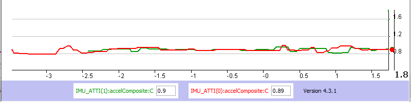

Looking at the 3 secs before the motors were started it can be seen that at least one of the accelerometers was incorrect. During this interval there should be no accelerations and the composite acceleration (i.e. acceleration modulus) will be exactly 1.0. In this case it appears to be about 0.9.
And here is the data from the previous flight where is the correct value of 1.0
Without knowing the attitude during this interval it can’t be determined which accelerometer(s) is incorrect. A non-horizontal attitude will cause accelX and accelY to be non-zero and accelZ to be not equal to -1.0. But, I’m going to guess that accelZ is incorrect; it’s value is about -0.85.
The Z axis accelerometer is oriented pointing down. An increase from -1.0 to -0.85 would mean the M2 is accelerating downwards. This, in turn, would cause the Flight Controller to think the M2 has a downward velocity. The GPS receiver derives down velocity from the doppler effect on the received GPS signals. Comparing that to the down velocity computed by the FC it can be seen that the FC’s down velocity is greater than the GPS down velocity.

More on this. In addition to the incident .DAT (FLY058) the two previous .DATs were submitted; FLY056 and FLY057. FLY057 was short and ended about 17 secs before FLY058 (the incident .DAT) started. What’s interesting is that the problems evident in FLY058 are not present in FLY057. In particular, the composite acceleration is very close to 1.0 and not the 0.85 just 17 seconds later.
