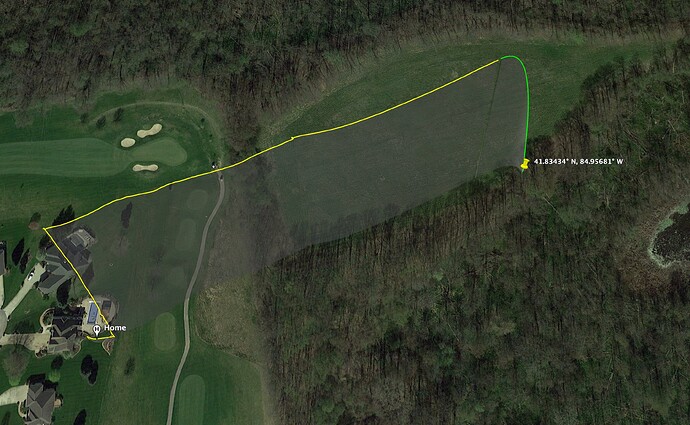

This is the second lost Spark this week. I personally do not understand why one would fly these tiny aircraft at 300ft. Irregardless of my opinion, you will have a most difficult time locating this one. Similar to the previous one this week, giving full elevator at loss of signal makes it tough. We do not know if you initiated any additional control inputs, although the last entry in the log and I mean the very last entry you released the elevator. You apparently only lost downlink. If that is the case you still had control and any additional inputs are not recorded. If I had to make a guess without significant data to go by, I would say that this little bird could be most anywhere. Most likely in the tree’s or in the small pond, depending on your control inputs after downlink loss, it could be quite a distance away, assuming of coarse that uplink control remained which we do not know. Your last inputs and location are shown below for what it is worth. Normally we could give you a better location, but I do not think that is possible here.

Making a few “assumptions” and calculations, lets “assume” the battery did indeed eject. Your last recorded speed was 30mph. This will gradually decrease over distance and altitude as the aircraft falls from 300ft. Using those numbers and the weight of the very light Spark, would give you a forward distance or ( Very Roughly ) 450-500ft. That combined with an approximate 5 second fall time will put your search area in the area of the red circle below. Again, this is assuming that the aircraft lost power. If that is not the case, all bets are off.

Actually that estimate is likely to be a bit off. The Spark only weighs 300 g and is going to be significantly affected by the wind field. If the AirData aerodynamic model is correct, that was around 15 mph @ 300°. I don’t have a calibrated drag model for the Spark but estimating, based on similar geometry to the Mavic gives the following descent track:
