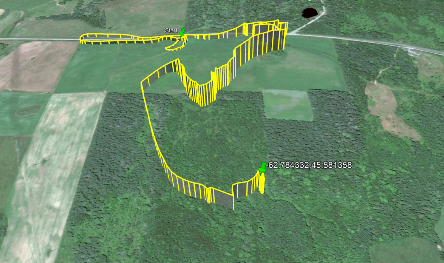

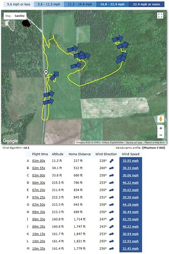

In answer to your question, without location data it is all guessing. Your last reported location is shown below. It appears it was trying to return home but the wind was too strong. At the time of data loss it was relatively stationary trying to move back to the home point that you changed from takeoff.
Yes, the wind was definitely too strong to be flying. Your Phantom had about 3 minutes of flight time remaining before it would have made it to the ground due to the battery reaching the critically low level. It likely continued to drift further away from the last location in the direction the wind was blowing.

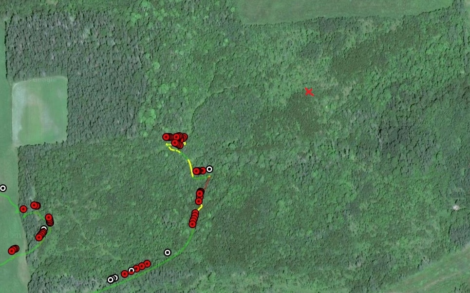

thanks for the helpful post, I’m going to go back out and travel the direction the wind was blowing in the last known location for about 3 km
found the drone this picture was helpful in giving direction of the way to go.
Great news! Where did you find it?
around this area of the red x

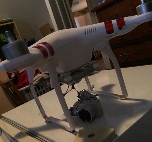

will be needing a few repairs tho
