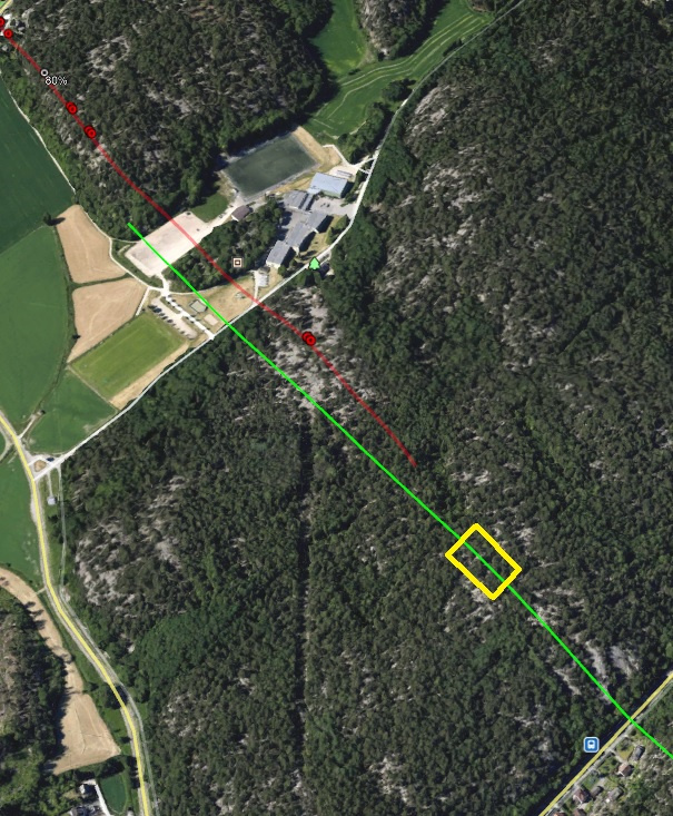

This is a very rough calculation, assuming that all variables are constant and a landing percentage of 10% battery. Assuming the drift direction and speed remained constant at an average of 10m/s, the aircraft would have drifted for quite a long way before auto landing and could be any where within the area below. As I said, it is only a guess and uncertainty is always a factor.
Since the aircraft was flying in ATTI mode at the end of the flight log, it would have landed at its current location after the remote controller disconnected. Assuming the remote controller disconnected at the end of the flight log, the aircraft would have drifted along with the wind for up to about 49 seconds while it was descending toward the ground. The actual time it took to land would likely be less than that since the terrain was higher than at the takeoff point.
The aircraft was drifting roughly in the direction of the green line in the image below. The yellow box is the furthest point I think it would have reached.
The last recorded location was 59.187483, 10.924945. The furthest possible point I think it would have reached is at 59.187723, 10.926245. I’d start searching at the furthest point and then walk toward the last recorded point. You can plug those coordinates into the map app on your mobile phone.
