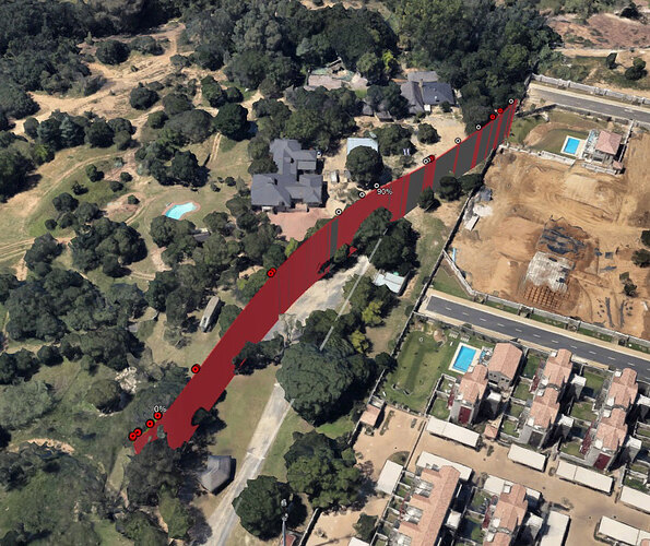

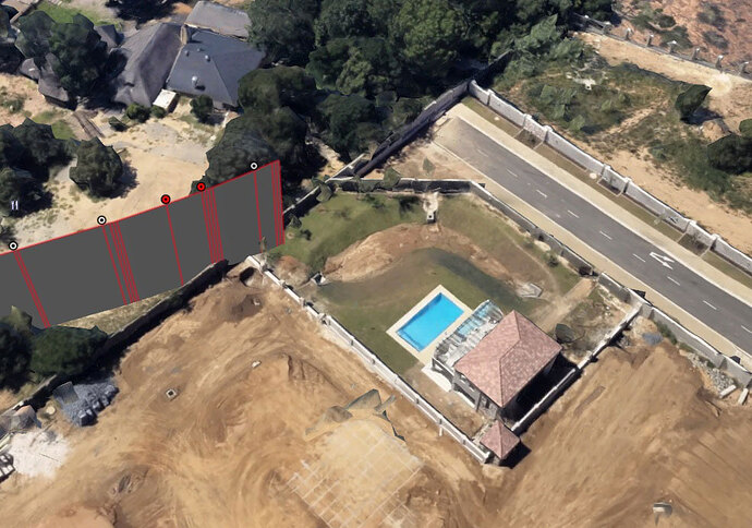

Here’s a link to your flight log:
http://www.phantomhelp.com/logviewer/TX8TPQGEO81JOG0595PX
Your Spark was hovering in ATTI mode at the end of your flight log. Since it was in ATTI mode, it would have auto landed at its current location 3 seconds after the remote controller disconnected. Look for it near the end of the flight path.
