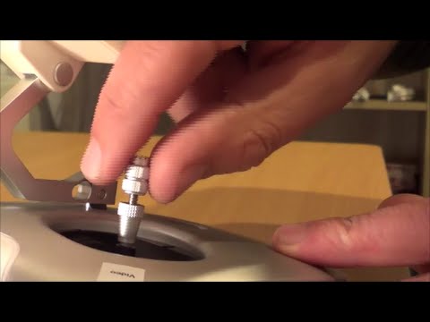

4) Increase the height of your remote controller sticks to allow for more precise movements. For best results, unscrew the tops of the sticks completely – and, then screw them on three full turns.
5) Install a product like PhantomKnobs (a product for Phantoms) to allow for a better grip on the remote controller sticks and/or to increase the height of the remote controller sticks.
