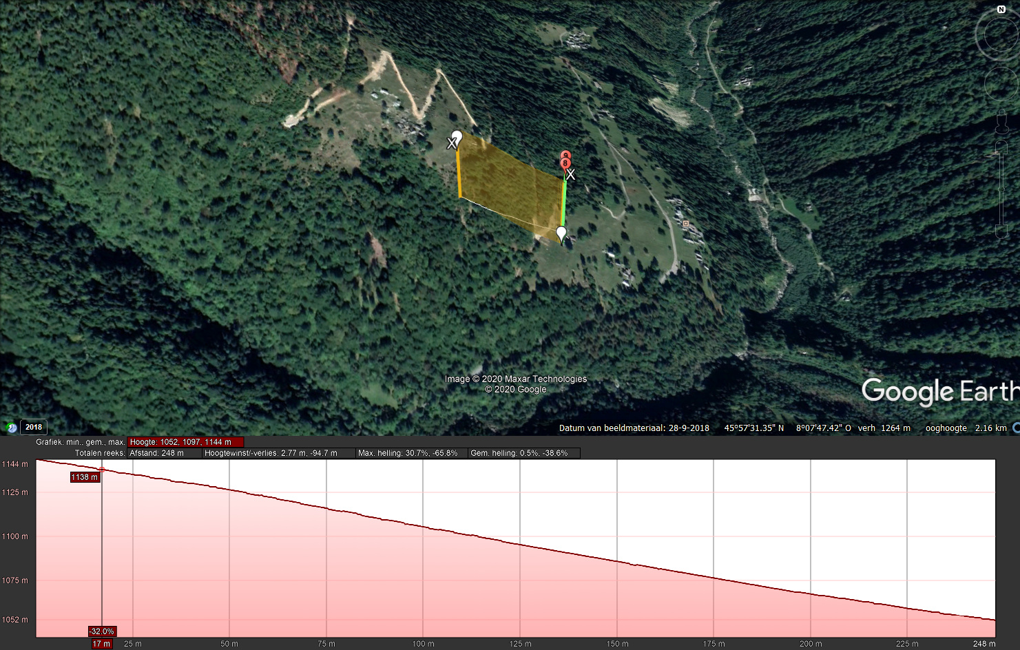

Checked the fly area, possible that the MM crashed, fly path is uphill,lowering to 105 meters relative from start point, where the last position is roughly 1144 - 1052 meters higher than start point.
last position = 45.95924100, 8.13626700.
BTW drone heading South with camera 10degrees up, so on the screen only free air was seen, not the mountain…

BTW, my point is that the find my drone position was impossible to reach for MM: it should have crossed a mountain climbing over 900 meters from the connection failed point! If you want, this is the map of the area: Last flight MM - Google My Maps
