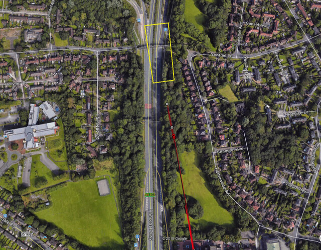

HI, seconds after being off the ground (mavic pro) i got a magnetic interferance error and it was off in the opposite direction, i had no control over it iexcept up which i used to try and slow it down hoping to reconnect. At some point i got it to RTH which it did but then flew away again, just hoping someone understands these logs and has some idea where it landed. fingers crossed
https://www.phantomhelp.com/logviewer/Q92VM2AHLKVLLRU76HJZ/
https://www.phantomhelp.com/logviewer/AR0J6K8553U95ATWQZHO/
https://www.phantomhelp.com/logviewer/ZD4KV6C6UOXAUVWWFLLO/
Thanks in advance for taking the time read my post
Your last flight log shows your Mavic was auto landing at 53.409676, -2.26629. Taking into consideration the altitude it was flying and the speed at which it was drifting away from the home point (due to the wind), it most likely landed somewhere in this yellow box:
