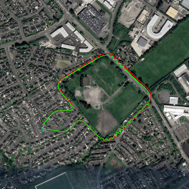

The IMUCalcs stuff is computed by CsvView; i.e. not recorded in the log file. IMUCalcs:positionError:C is an arbitrary threshold and set to true if the distance between that reported in the log file and that computed by CsvView is greater than 6 meters. Looking at the path reported in the log file (red) and the path derived from IMU data (green) it can be seen that the agreement is pretty good.
Bottom line is there is no indication of an IMU error.
