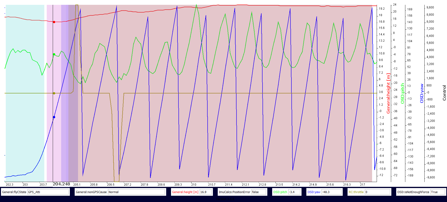

One of my pilots experienced a crash. The flight log is below. The only warning was speed error. He states he was flying and without warning the drone started to spin wildly, as you can see on the log. Anyone have any ideas what the heck happened???

Not from what I am seeing. The spin is far too linear and the attitude angles co-incide with that. It does not have the typical “lost prop” signature.

As stated previously, this does not have the “typical” signs of a lost prop. Generally speaking a lost prop will cause an exctreme pitch or yaw angle upon loss. This one does not exhibit that effect. The pitch oscillations began ~5 seconds before the spin began, which would lead me to believe a motor or an ESC issue was the culprit. Granted prop loss is possible and with the device .dat ( That was requested previously ) would provide more detail. Specifically motor speeds. The notEnoughforce flag went true right at the spin point, which could suggest either or, prop loss included. As I said this is just not a typical response in the data that I have seen with a lost prop. See the link below to locate the device .dat, if you would like this looked at in more detail.

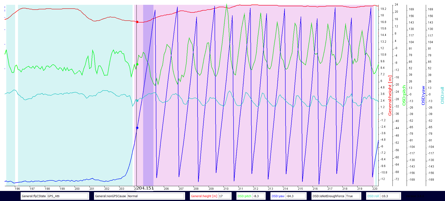

As mentioned previously, this does not look like a lost prop. That being said, to me it looks like an issue with the ESC and/or the front left motor. I appologize for the “buisiness” of the graph, but you can see the issue began just before the first yaw around prior to the spin, which was ~14 seconds before the spins and descent began. Notice how the AVG Current climbed ( Black Line ) and the actual current (
Dark Purple Line) and got worse as the spin started. This to me indicates either the ESC and/or the motor. I can’t say which. But I will have @sar104 take a look when he has the chance to confirm one, the other or possibly both. I will ask you however which prop was missing when you retrieved the aircraft? Was it the left rear?

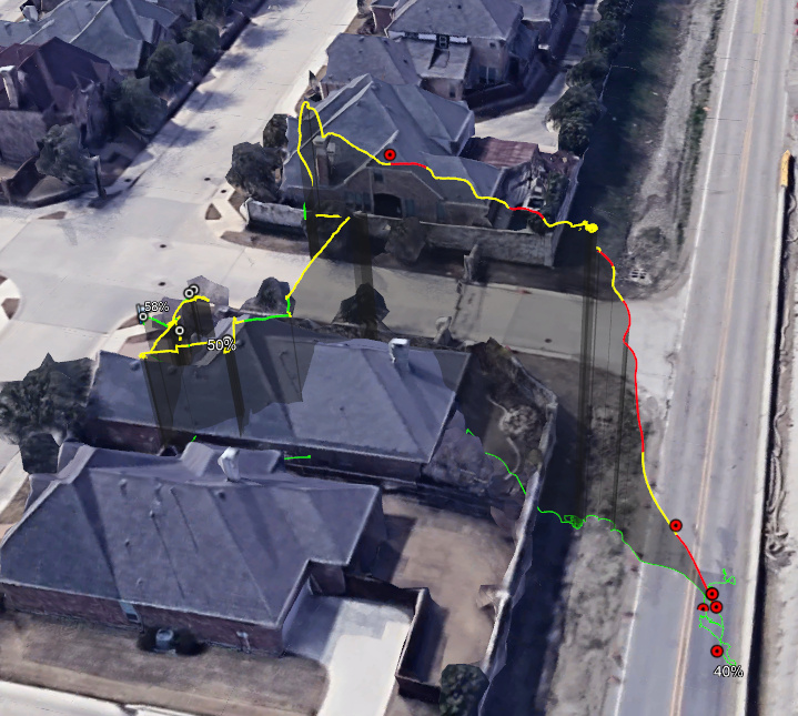

Just to throw this out there. Is it possible that “the pilot” hit the roof of the home he was overflying? The altitude was only around 50ft or so at that point. I say that because that is where the gyro data went off the deep end and the spin began shortly after. That would explain a lot if that were the case. It looks like he “might” have. If you scroll through the flight on the Phnatom help site, the data corresponds.
A 50 foot one story house? That doesn’t seem very likely.
Said he didn’t hit the roof. He was climbing to get a higher angle shot.
