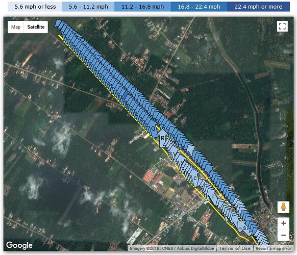

please help to analyze log…
headwind when return???
thanks…

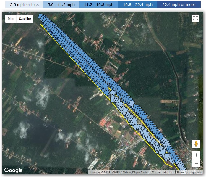

Yes, wind was definitely a factor. While it wasn’t too strong for your Mavic Air to fly, it was strong enough to cause your Mavic Air to slow down at some points on its journey back to the home point.
Here are the wind speeds calculated by Airdata:
thanks for help…
so the conclusion is headwind causes the aircraft speed slow down or battery life to decrease???
Flying into a headwind will cause the speed to slow down if the wind is too strong. And it will require more battery power since the aircraft is working harder to attempt to maintain the commanded speed.
