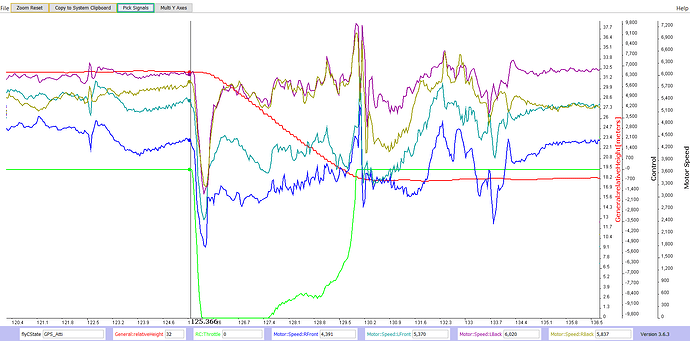

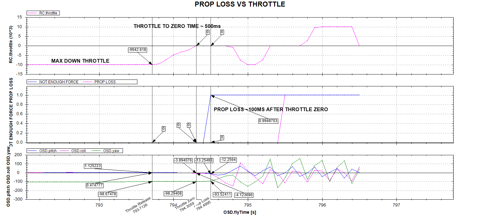

You are correct in that statement. It is not the fact that the motors are slowing down or vice versa, it is the speed in which they do this. An example file ( Not this flight ) that shows a full throttle down. However, bear in mind that this particular example is approximately 3 seconds between full down and zero throttle and also shows the motor RPM’s. The issue is the abruptness of the change. The chart underneath shows that in this particular flight, the throttle release time was approx 500ms, as opposed to the 3 second ease off in the example graph. The point is the quick change. A hub crack would also be a possibility, which would essentially be the same as ejection.
Thanks for your patient explanation. I think my confusion is the same with @NotBillyBob. I fully understand the problem of full up throttle to full down (sudden slowing of the motors can cause the inertia of the rotors to outpace the motors and loosen the rotors). But you are saying full throttle down to zero can also cause prop loose but not due to the reason of inertia but due to a quick change.
It is the speed of the change, very similar to hard fast braking. As I mentioned a hub crack from the change could also occur, which would do basically the same thing. In your flight, it was around 100ms after your throttle reached zero when it appears the prop ejected. Did you locate it and was the hub cracked?
