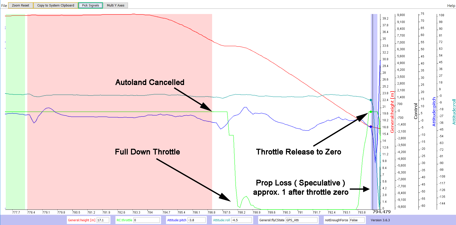

@cheddarman If this makes it clearer, generally speaking these props ( If not properly tightened ), will loosen upon a hard change in throttle, due to the motors slowing down very quickly upon release. The metal hub props do not secure as well as the OEM plastic hubs. In relation to this instance you can see the probable prop loss below:
So, that explains what caused your crash. See my post above regarding things that can cause props to fly off mid-flight.

One small piece of advice here. When landing manually, ease the aircraft down. Don’t attempt to land too quickly ( Except in an emergency situation ). As noted in the graph above, going from full down throttle to zero can eject a prop.
@victorsun This is from your good flight. Notice again the extreme’s in the full throttle down and zero ( Green line )…
