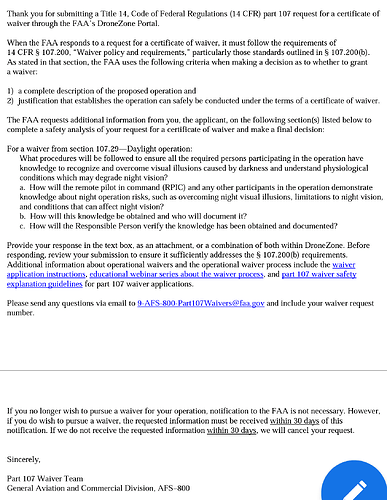

I submitted what I thought was a complete and thurough application for a night waiver and got this letter back from the FAA.
This was my response to the letter and to my excitement the waiver was approved!
- Description: The proposed operation would be for night photography and after gaining a large amount of night experience would eventually like to move into SAR Operations. This waiver would allow me and at least 1 visual observer to fly at night for the purpose of night photography.
- Safety: In Classed Airspace I would attempt to ensure the local tower is aware. I would provide my location and approximate distance from the Airport center and in which direction I am from center. In the event of a flyaway, I will have communications established with the VO via cell phone or walkie talkie and would immediately dispatch the VO and other assistants if available to keep eyes on the SUAS and if possible to follow on foot or in a vehicle. If in classed airspace I would notify the airport control tower of the flyaway and if necessary the local authorities. I will fly a preplanned path via GPS waypoints. Prior to the night flight, this preplanned path will be flown in the daytime to check for obstructions or hazards that we may not be able to see at night. I will not fly over people in the open and through the daytime flight I will establish a safe altitude to fly that will allow safe clearances from any and all obstacles along the path. To ensure VLOS can be maintained, I have my SUAS outfitted with 4 “ARC” Cree Professional Series Strobe lights. It features 4 Cree lights in one unit with 3 lighting modes, Strobe, Flash, and a fixed (solid) mode. I have 4 of these lights installed on the SUAS 2 White, 1 Red, and 1 Green. Green (fixed) on the right leg, red (fixed) on the left leg, and 2 white (strobe), 1 on each back leg for 360° visibility. This should be more than adequate to satisfy FAA 107.29 compliant lights for night flights. The CREE bulbs give it clear visibility well in excess of the FAA 107 requirement for night flights (3+ SM Miles) and greatly helps in maintaining VLOS while in flight for the RPIC or a nearby manned aircraft pilot. There will be no close calls as I will yield and if necessary land in a predetermined area to avoid any and all manned aircraft. It features a 250 mhr battery rechargeable battery which provides approx 6 hours of run time in strobe mode and at least 4 hours in fixed mode.
- Visual illusions: I am an active private pilot and have studied how to recognize and overcome visual illusions caused by darkness and understand physiological conditions which may degrade night vision. Although I have studied this previously, I have signed up for an online course on this topic and have passed the course with 100% score just to be on the side of safety. I am working on creating a 20 question test from the Pilots Handbook Of Aeronautical knowledge (FAA-H-8083-25B) similar to the online test I took. I will give this test to the VO as well as discuss and deficiencies once the test is completed. I will administer, grade, and retain a copy of the test for the duration of the operation / night waiver.
Maybe this will help someone trying to apply for a waiver.
