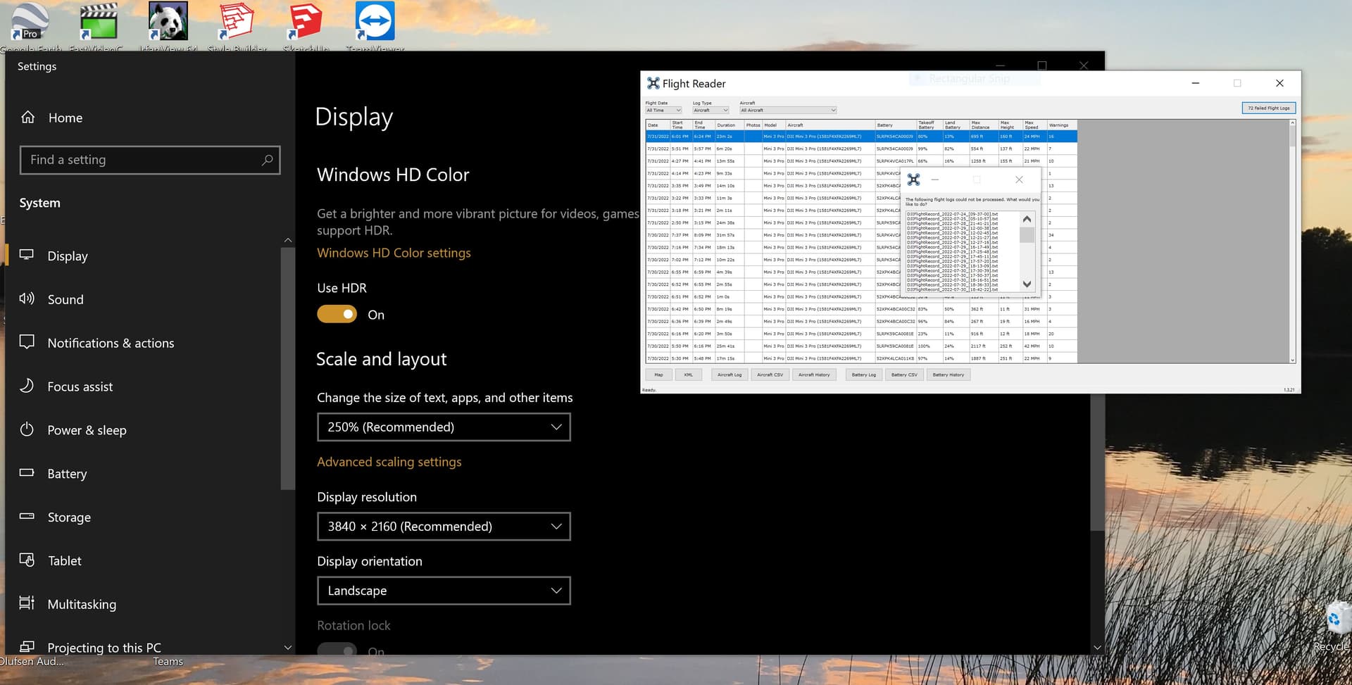

I had an idea…
I set "text, apps, other items " to 100%–which setting makes the display completely useless, but
*the buttons in the Failed Logs windows are visible, and
*when either Main of Failed logs goes to the 2nd monitor the font size is appropriate useful, not huge.
However,
The window still does not resize itself to the monitor, will not snap or dock to full screen.
And when the windows display settings for “textx,apps…” is changed back to another % setting neither of these windows responds properly when compared to other program windows…
**the -interior- of failed logs window grows slightly but the outside window dimension does not. The interior overrides then hides the buttons. The similar inside/outside dimension mismatch occurs in the main window as well, but not as badly.
**when adjusting the "text,apps,etc."setting, The Font does not enlarge in Either Main or Fail Logs window, causing the program to remain useless with tiny text on the main screen.
***->on restart of the program with the “text,apps” setting restored to a larger value (like 250%), the Flight Reader and Failed Logs windows Still do not respond to the new setting…the font went to the smaller size and before closing, didn’t grow with the text/app adjustment before closing, and didn’t resize even after shutting down the program and restarting it.
However–look at the aircraft log window in the third shot. It did respond to the Text/app adjustments and is restored to the correct and useable font size within the window—and again, this window is very appropriate when moving from monitor to monitor as regards auto resizing, docking, full screen behavior. The font in the main FR and Failed Logs window should have grown and should have again become more like the size in the Aircraft log window, but they did not. The behavior in the Aircraf Log windos seems to have correct programming.
Currently, Flight Reader is again useless to me. I cannot get the font size to become restored to the original and appropriate size.
