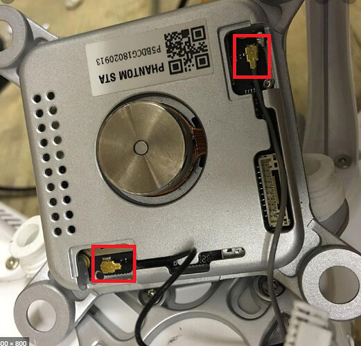

Are the connectors on top of the gimbal damaged and/or corroded? If so, that could explain your image transmission issues.
Hello msinger
No they are in good condition. The whole gimbal doesn’t work due to salt water splashing onto it.
I think my main problem is that my RC always disconnects from the drone and I lose GPS signal straight away, I have tried linking the RC again but doesn’t make a difference, and even though I just downloaded a fresh copy of the DJI App I can’t do a firmware update because I’m getting gimbal error messages in red on the screen.
I think this is the problem? Do you know anything I can try do to get around this. I’m not fussed if I can’t take videos but I need the DJI App to work while flying
Thank you for your help
You won’t be able to update the firmware if the gimbal doesn’t work. It sounds like you’ll need to replace your gimbal.
