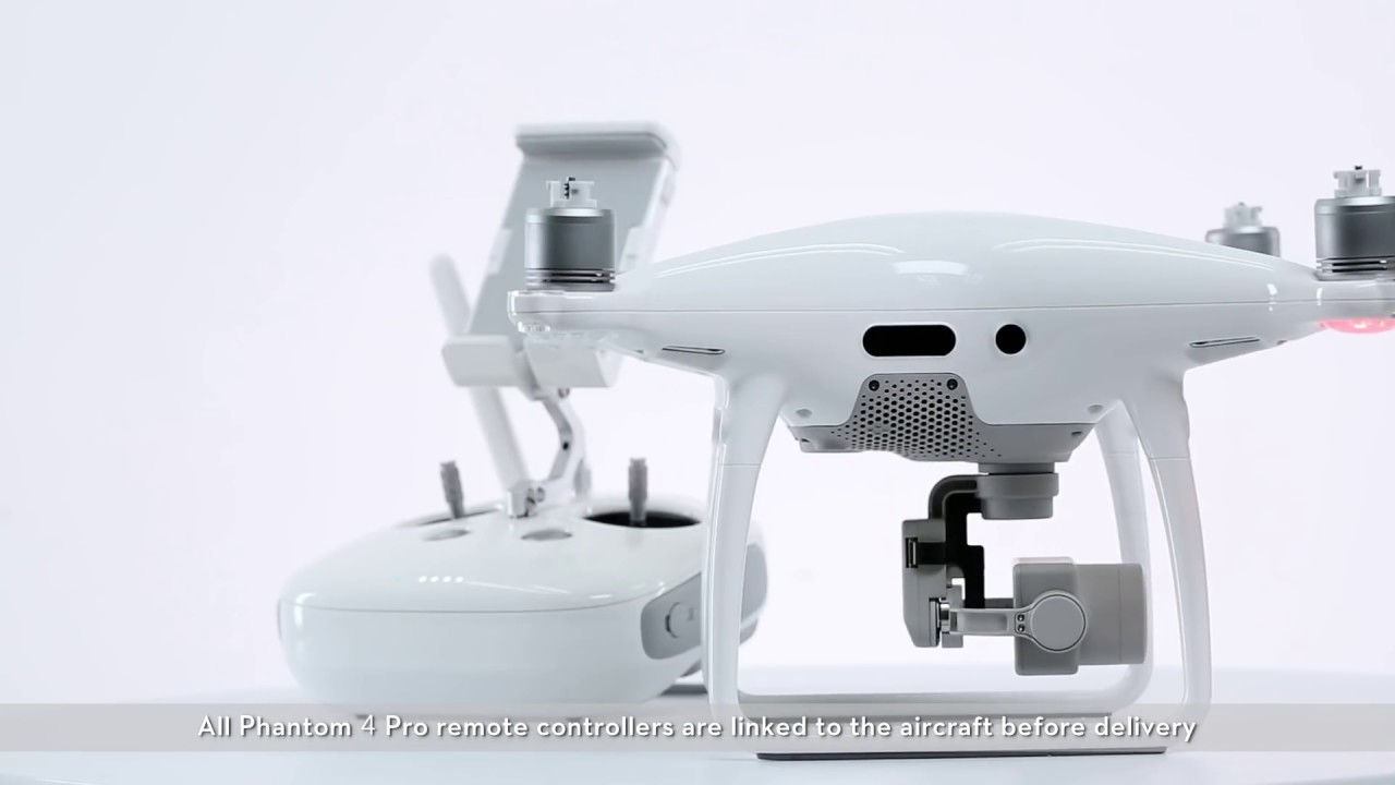

I do not own a P4 and I now think I am wrong about the binding of the drone to an account… If so, then you can ignore the previous warning.
These YouTube Videos probably provide the instructions you need to fly your Drone.
