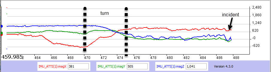

It’s tempting to conclude that the geomagnetic distortion caused by the steel construction contributed to this incident. But, the Avata flew for about 10 secs inside the steel structure without incident and then rolled CCW without any apparent changes in the distortion.
At about 470 secs the Avata rotated CCW and started entering the steel over structure. At 475 secs the entrance was completed and the flight path through the steel over structure was established. Magnetometer data didn’t vary much until about 486 secs when the uncommanded roll happened.
Here is the magnetometer data
