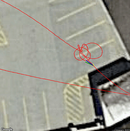

Any ideas about the yaw error at 0m 52.6s in the flight log?

At 52.6s, I just started to fly over that low parking garage so my only guess is that the metal in the structure caused compass interference.

The Spark was not close enough to that structure for it to negatively affect the compass. Magnetic metal objects should have no effect on the compass until they are less than a foot away from the Spark.

I didn’t notice the switch to ATTI at 56.2 secs. More interesting is the toilet bowling that happened starting at 21 secs.
There was nothing unusual in the magnetometer data. It happened just as full elevator was removed.
Still a mystery to me. But, I don’t think it’s related to the Precision landing problem.
Funny thing is I don’t see any toilet bowling in the video cache.
Is there a video to share? Or, are you talking about the still images that the Go App stores in the .txt? If the latter, then there are probably not enough stills to discern the toilet bowling.
